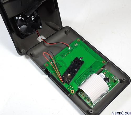

) m; [9 l, U; R4 FHere's the unit, popped open. The fan is attached to the back of the case. The black thing on the green circuit board is a piece of & W3 M$ r. |5 o" ?* {
* S2 ?+ @4 t0 X1 q
plastic for holding the laser. I think its main purpose is to prevent diffracted light from the laser beam's aperture from getting to
; h8 ^/ ]5 Y3 I4 g) D- L3 _
' b% h' _: i! Pthe detector.2 w2 @; N; i& Z( \! P! W" o, i

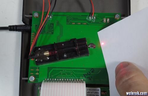

( C$ L( e, @; ^Plugged in, holding a piece of paper in the laser's path.
# _3 Y' S, T1 b) D! e" {The laser is about as bright as a laser pointer laser. The small component between the piece of paper and the black thing that / x$ h6 K6 i4 j+ E( ?( r
5 x6 g; V$ B: j% Q# vmounts the laser is a photo detector of sorts. The laser is focused to have the narrowest part of its beam right above the photo ! m9 F* g! c* T2 R) A0 |
2 I  m3 p9 P" P( K6 b4 h
detector.

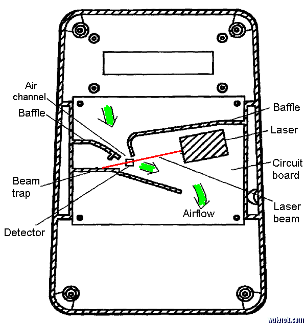

I looked up the patent number on the back of the unit, and found it here: US patent 8009290
6 {. g6 H1 K9 E5 v( P% \, ]I re-label;ed one of the drawings from the patent. The arrows, highlighted in green, show the direction of air flow.
) F' j4 s) j% ?4 u5 SDust particles passing through the laser beam above the detector will deflect some of the light onto the detector. Larger particles
+ z7 o4 E. J: {
5 {/ d3 y* [" B/ W6 Swill scatter more light, so particle size is gauged by the intensity of the pulse of light on the detector.6 p' d/ }  o$ U" \4 S
- m0 f9 {% a- u. D1 _! v, j2 F* \3 U

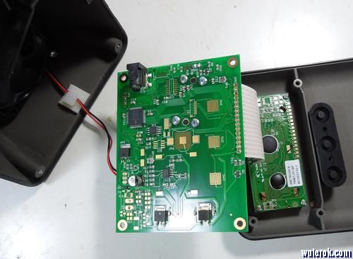

1 ^6 b7 |, w1 A/ JUnscrewing the main circuit board reveals the circuitry behind it. A micro controller, some analog components, and the pads for
  a! f, _" g; i1 p! a/ p3 ?" y& {" T9 ]3 D0 S
the three buttons.
7 @0 H8 Q, |0 d& F3 q; {0 g; \9 V* r- Y1 @8 B& ^5 }2 D1 \
! h+ F! }. ~/ u" {% H
A close up of the main circuit board, for those who are curious as to what the chip part numbers are (click to enlarge)# q( |4 @" M4 ^
- {) m# ^. \2 k& K8 r5 l

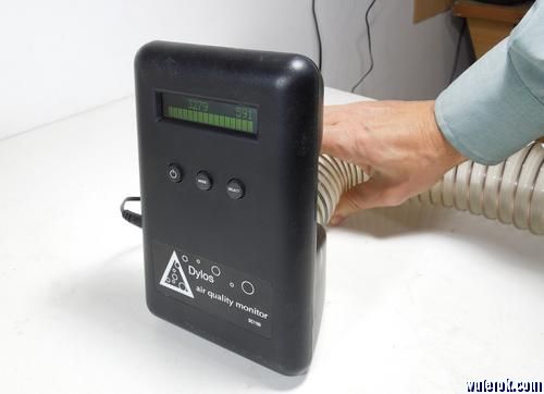

With just a CPU fan providing the air flow, the meter is not suitable for sampling fast moving streams of air. Obstructing the air $ h& U4 D+ h9 B5 ^5 W2 u* a4 `
% p8 J5 y1 X% a7 ?5 F. j
flow makes the counts go down, and increasing it makes it go up. Here I'm using my dust collector to pull more air through the
9 d7 q. t" l5 h: B: r. f8 g/ Z; y; M7 z
unit than normal. Doing so tripled the readings on the meter. So varying the air flow rate can definitely change the readings. The

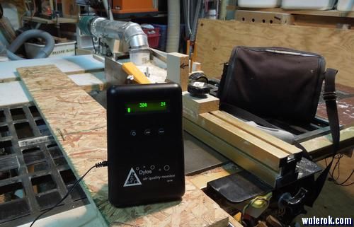

$ x  o2 i5 a: \/ YThe nice thing about this meter is that it gives a numerical reading within about ten seconds of powering it up, so it's good for
. L- B' `& j& w6 A2 k& D. S& l/ o
) V7 O7 _- K6 H1 ?! pcomparative purposes. I used a fan to blow air through my washable reusable furnace filter (on the floor in this photo) and
) k1 r3 T0 ?* T. i- D3 d
$ ?$ d- ~) m% F% [# ?' Q/ Z1 dholding the meter on the other side of that filter, found the readings were the same as for the room air. So the filter really wasn't
9 |3 H! r3 p$ F3 _( ~" c( ~$ n9 e+ H% A$ j8 V. i8 A3 ?
capturing any of the fine dust., v" t+ k* B' n  n5 n

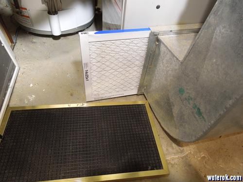

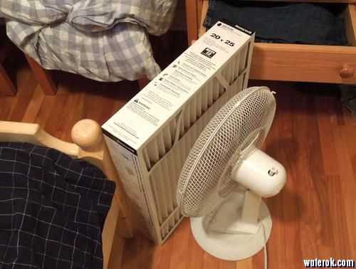

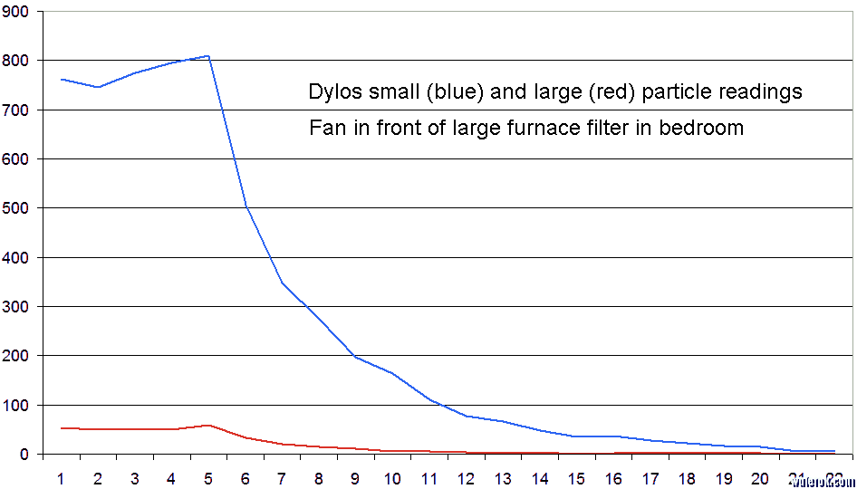

7 d0 v. G4 _7 G1 bFor experimenting, I also bought the biggest furnace filter cartridge I could find. I found that just blowing air through it with a regular fan really cut down on the particle counts in the room. After about 15 minutes like this in my bedroom, the particle count dropped from around 800 and 60 (small and large particles) to 15 and 0.
2 g0 v: \# ~9 @* a3 z' G7 y6 U6 V4 L* _+ C( J3 g# ?
bedroom_graph.png $ h+ k! `0 {2 S4 ?5 a( G; @
At $30, this filter is still much cheaper than the cheapest air cleaner. So if you suspect that an air cleaner could help you with allergy problems, buy one of these big furnace filters and put it in front of a fan, just as an experiment.
2 }/ W. Z0 P) W) x8 SI don't know how well these furnace filters work over time compared to HEPA filters in most air cleaners, but when they are new, just blowing air through them like that really works!
. M! H- O0 l3 e' D3 I0 u  |1 m, Z$ N& z9 k- @2 G  {

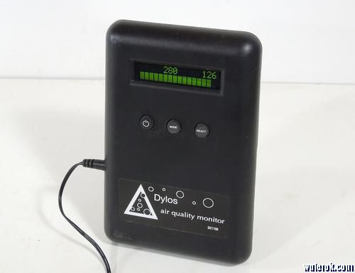

With my new furnace filter, typical readings indoors are about 300 of the 0.5 to 2.5 micron particles. But I found day to day readings varied quite a lot. A big source of variations, it turns out, was outside air. On some days, the outside air read at about 9000 microparticles...0 r. Q0 E! Q, a3 \$ K
5 |3 r5 |; f  f. H: v
/ ?) b' ?9 r# }9 r8 F1 e5 Y
... but sometimes, it was as low as 300. It all depends on wind, rain and recent precipitation.
6 x9 n7 J. y/ b: K8 D; a+ T+ u6 V" R; z( m4 D

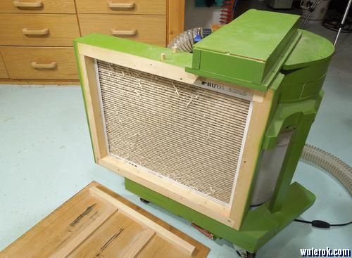

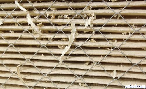

The Dylos confirmed that the air coming out of my small dust collector wasn't terribly clean, giving typical readings of around 2000 and 600. The microparticle filter, used this way just doesn't work that well. Although a particle count of 2000 is not that bad while running machines. Typical indoor air is often around 1000, and workshop air, when using power tools, is usually higher.5 E1 \9 b/ v' N! N
! ]; g+ G1 f" {+ {/ ^. b. ^
# v% m" i3 [6 B5 \I'm hoping the filter will cake up over time to make the filter work better, but this may or may not work. These microparticle furnace filters work by attracting the microparticles with static electricity. Probably, once enough dirt is in the filter, that mechanism breaks down.

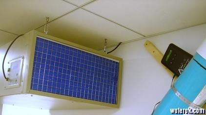

/ F& G7 I1 X- b6 Y8 b# U* ?My guess is that true HEPA filters are impractical for furnaces, because HEPA filters have very fine pores and create too much air resistance for a furnace. Certainly, with all the fancy terms used to describe the more expensive filters, none claimed to be a HEPA filter.
2 Z9 o' a9 y# X: Z3 }) _9 B# S" \But in the mean time, this pleated filter, even not working as designed, is still my best option for my small dust collector.
' A- X+ l. Y) k) n2 k2 `, J: ^, Q% x, N) m

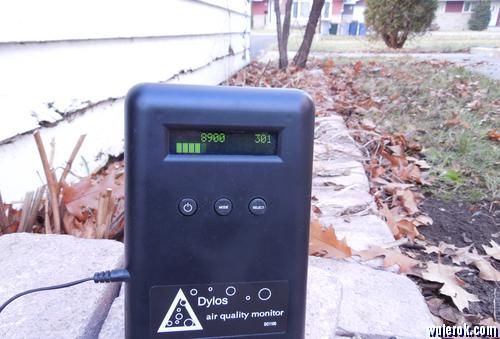

% u* B& D8 x( v4 o- \; v$ G6 ^& kBut in Bill's backyard shop, where he keeps his ShopBot CNC machine, the particle count was really low, around 300 and 25.
5 Y4 Z! h* v5 m  IBill said he was milling some gears out of plastic earlier that day, and my guess is that milling the plastic didn't make a lot of dust, but pulling the air through his dust collector in that shop still removed most of the regular airborne dust. That dust collector uses the better quality filter bags.
8 s* l; m* D" m' STo put things in perspective, the particle count in Bill's back yard that evening was 3000, about the same as in Bill's garage workshop., Z3 Z  ?8 r; K

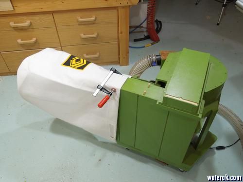

% I& Z; M9 o; ^7 b6 X2 QSo bought a small replacement filter bag from Busy Bee tools, the same style as on Bill's better dust collector. This bag is supposed to filter to about 1 micron. The bag is made of some felt-like material.
3 B% n4 [5 Q4 F) N9 _As far as I can tell, it doesn't work as well as advertised but blowing air through it does reduce the small particle counts. So for the time being, I stuck it over the air outlet on my small dust collector, fixed in place with a clamp. The air coming out the filter bag reads about 300 particles, so the bag catches a lot that the furnace filter doesn't catch.4 o' G! S7 e- y' y* K  X
The filter bag only cost about $26. Had I known what I know now, I would have designed my dust collector to use one of these in the first place. Or maybe I should try to make a pleated filter from that bag.

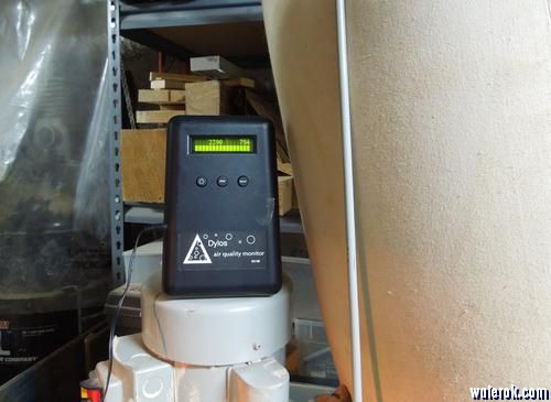

, q* f/ Q9 d1 r6 i- P- d4 UI wasn't expecting my big dust collector to perform terribly well. The fitter bag on it is just covered with dust, and if I run my hands along the inflated bag, I can see a cloud of dust released from it.
2 i6 K" m. V$ N) AWhen I start it, it also releases a cloud of dust as the bag inflates. But once it's running for a minute, the readings on the Dylos really drop. After about four minutes, the Dylos, right next to it, will read counts below 50! But if I as much as stroke my hand across the filter bag while it's running, the counts go up immediately.
9 L6 z2 Q3 S5 @# K5 CStill, with a storm of dust going on inside that bag, the air coming out of it has a much lower particle count than outside air.
0 _1 `% }! x9 ^
# \; m" f5 \+ U8 C3 |8 |, b# dMakes you wonder whether venting your dust collector to the outside, as Bill Pentz suggests, is always a good idea.[/url]  b" x. H5 m% E2 u( {
! P3 W2 ]+ v3 q% F8 v0 X

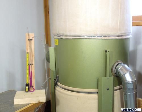

Most filters get more "efficient" at filtering out dust particles over time, a process that is referred to as a filter getting "seasoned". 0 k3 i; ^9 G! w9 m6 Y
0 V: e, R  d/ c/ Z" _; |
A filter isn't really like a sieve, more like a tangle of fine fibers that particles get caught in. As all the largest pathways through the fibers get plugged up with larger particles, only smaller pathways remain, which in turn trap more of the particles.
" O7 V, h3 i$ a"Efficient" is a relative term though, because as the filter's air pathways become smaller, it develops more air resistance. So for the same airflow, the filter will produce increasing amounts of back-pressure.

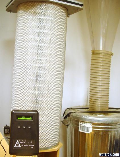

) n8 e0 F% w  c; e/ MI measured the pressure inside my dust collector at 45 mm water. Definitely higher than any other air filter I have, but then again, still much less back-pressure than the cyclone aloneon my homemade small dust collector. Given that this filter does not need a cyclone upstream, 45 mm of back-pressure is not bad.
+ m; H4 Y+ h$ k3 w) d& b* j& z$ }: Z; g# X2 a$ D' U: i5 \
% _4 G  r& v7 `$ U, M  N0 GA reader, Daniel Chernoff, wrote to me that he has the same model of Dylos that I have, plus various dust collection equipment. I figured this would be a good opportunity to get some comparative readings, so here's some of Daniel's readings:( n2 f" ^. l; m# ^
2 U- C- ~9 ?) SFor his dust collector, which is a ClearVue cyclone with six year old Wynn cartridge filters on the output. The baseline reading in the undisturbed shop is around 93 and 33 (< 2.5 micron and > 2.5 micron). With the Dylos right by the filter, the readings went up to 300 and 40 when the dust collector was turned on, then settled back down to around 250 and 5. Then using the chopsaw (connected to the dust collector) to make about ten cuts in hardwood, the readings went to 401 and 39. Two minutes later, the readings went back down to 327 and 37." U; o& `- V. q" E7 r
Daniel also cleaned out the inside of his canister, but the particle counts coming out of it were higher after cleaning it. That is my experience as well - any disturbance of a filter, including cleaning it, will, at least for a while, cause it to release more particles.
0 N* O4 W$ P# _, i8 A) L, ?Comparing Daniels's measurements to my measurements with my large bag dust collector, and Bill Price's bag dust collector in his backyard shop, suggests that pleated filters aren't necessarily better than a good quality filter bag.* M" g) H7 S6 n$ _! b7 B0 L3 a
Daniel also disconnected the filter to see how the cyclone alone would do. This emitted a cloud of dust blown out from the filter, with readings going up to 20,000 and 10,000, though four minutes later, that settled back down to 1100 and 300./ Y' m: H% n" A
I'm pretty sure that cyclones alone are ineffective at separating the fine dust. The spinning air inside a cyclone is subject to on the order of 100g of acceleration, but the air only stays in the cyclone for about one second. Assuming particle separation rate is : u( Z; [0 T  Y  d" D) n

Daniel also tested it next to his JDS air cleaner. The blue filter is the output side of the air cleaner. After five minutes of running, the Dylos was reading 140 and 16. With the air cleaner turned off, it then settled back to around 250 and 40.
1 v4 w+ a( D2 }4 d( v9 t* S
4 K" _/ a; \! M% C. u

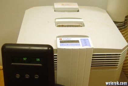

Daniel also has a IQAir HEPA air cleaner. After five minutes of running, the Dylos read 92 and 17. Daniel says "From experience if I let the HEPA cleaner run for hours I can get the particle count even lower, usually around 15 and 0".
# t# C+ S1 i, E8 U0 K( T  p6 T" q% V& O3 C  A3 C
